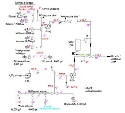

We use a variety of solvents at our pharmaceutical plant. Until recently, we largely ignored the vent system feeding our thermal oxidizer (TOX). Although the decanting and distillation tower for separating solvents works flawlessly, the TOX system sometimes acts up; the environmental regulators forced us to install a backup system. Lately, the vent system drew our attention when vapor detectors caused a trip during new solvent unloading. Then, everything went haywire. I was sent by corporate to investigate.
The operator claims the suction is very bad and truck drivers complain about the fumes. I found out that, to avoid the fumes, the drivers hook up and walk away and the operator watches from the control station. Plant engineering gripes that a series of expansion projects connected to the system without addressing underlying problems. With budget cuts, corporate says there isn’t any money. One engineer grumbles that the vent alarm is faulty; he says the over-loaded distributed control system suffers from a power supply problem that causes alarm trips.
As I expected, the utility piping and instrumentation diagrams are a joke. The line sizes are missing and many vent connections either don’t appear or go to unused tanks. I found a show-stopper: a tank with a blind flange removed from a vent nozzle. Maintenance is pretty sure the slide gate is closed on the abandoned tank and says not to worry about it. I drew up a quick flow diagram to begin my investigation (Figure 1).
Vent System
Figure 1. Long-ignored system caused intermittent alarm trips and now has gone haywire.
A walkdown of the system showed corrosion and water vapor at some of the flanges, duct joints and two blowers, (F-55 and F-400, the main blower). The other blower (F-65) looks clean because the tank hardly ever is emptied. Maintenance says the corrosion is normal.
Where should I start? What should I do about the abandoned tank?
