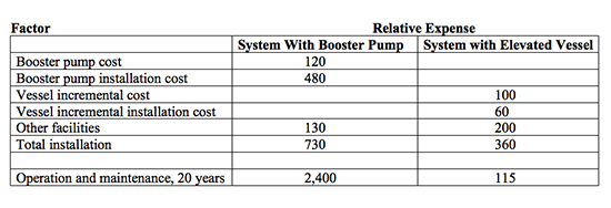

Comparison Of Two Options
Table 1. A system relying on an elevated vessel incurs far lower long-term costs.
Typically, purchase and installation only account for 20–25% of a pump’s lifecycle cost (which also includes both energy and maintenance expenses) over 20 years. In comparison, for a simple separator vessel, the 20-yr lifecycle cost generally splits closer to 75% capital and 25% maintenance.
Table 1 compares the costs of the two options. The installation cost is based on a fully engineered design and a ±10% cost estimate. The lifecycle costs are based on experience and rules-of-thumb for the equipment involved.
The elevated vessel boasts both lower capital and lifecycle costs. It’s the clear choice unless there’s an overwhelming reason for having a booster pump. The higher vessel also offers a safety benefit —elevating the vessel above 25 ft removes it from the standard pool-fire zone.
