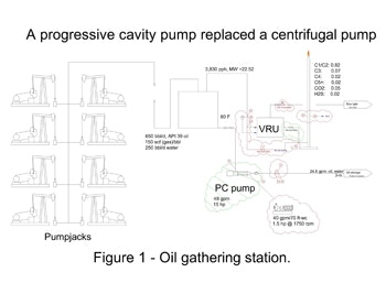

The pipeline company I work for replaced some centrifugal pumps (CPs) that performed well for over 20 years with progressive cavity (PC) pumps at an old oilfield gathering station. (See online figure.) After two months’ operation, the PC pumps suddenly failed. Because the station is down, the company decided to do some much needed maintenance. While sniffing for leaks before construction could begin, we discovered several, in particular around the new pumps. In addition, it looks like regulators will ding us for over-using our flare and for complaints about hydrogen sulfide emissions because the flare failed to ignite properly.
My first problem is finding out why the PC pumps failed and what to do about the flare. We had relied on a world-renowned engineering company for the previous work; it had highly recommended a particular make of PC pumps. However, my company opted for a different pump vendor because maintenance insisted on the brand for “consistency” in the equipment inventory. The engineering company also installed a new flare ignition system about the time of the pump replacement.
Why do you think the CPs ran so well for so long and the PC pumps failed? Is the flare problem somehow connected with the pump failure? What other thoughts do you have?

Figure 1. One reader recommends a variety of significant changes, as shown in red.
The PC pumps failed after only two months. Did the alternative pump vendor meet all of the engineering specs? Were the manufacturer’s installation, operations and maintenance recommendations available and followed? Is there adequate NPSH for all operating conditions? Send the pump(s), with history and operating conditions, to the manufacturer for inspection. That vendor can tell you a lot. In many cases, it will bear or share the repair cost under warranty. Consider sending the second pump to an independent pump repair shop.
The PC pump will move 48 gpm but you only need 25 gpm. Consider the changes in red in Figure 1. Because the PC pump essentially is a positive displacement pump, either speed control or recycle is required for a steady 25 gpm. Alternatively, the pump can be an on/off operation, but initially pumping only water may flush the lubricant on the seals and lead to early seal failure.
Based on the 15-hp motor, the pump discharge is about 180–250 psid. Unless the oil storage is a long way off, you only need about 10–30 psig pump discharge to flow to an atmospheric storage tank. A small centrifugal pump, operating at 1,200–1,800 RPM to minimize NPSH-required, should work well. The CP should be able to handle solids up to about ¼–½ in. so use a suction strainer without the screen to minimize suction pressure drop.
The block labeled “VRU” looks more like a separator and the box next to “Carseal Open” would be the VRU. The separator should operate at lowest possible pressure so as to minimize vapors at the oil separation/storage area. A VRU package normally tries to maintain a suction pressure between 1–8 oz. (2–14 in. H2O). The piping and components between the separator and the VRU will cause pressure drop and surges, especially if the piping has pockets. If the VRU is not very close to the separator, then locate the suction pressure transmitter on the separator. Take precautions that the VRU does not create a vacuum and pull oxygen into the system.
