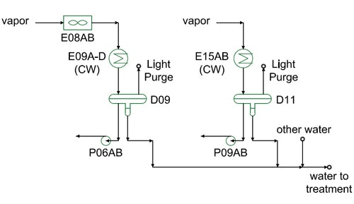

A wastewater plant needed to reduce its emissions of volatile organic compounds. Troubleshooting identified excess light hydrocarbons in the water as the culprit. The water came from a common wastewater collection header shared by two distillation columns. Samples from different points on the header isolated the possible problem source as being the overhead system of one of two towers. Both had the same configuration (Figure 1).
Overhead System Configuration
Figure 1. Both towers have water as a minor contaminant and a low water purge rate.
Water purge rates from both towers were very low. In each system, water was a minor contaminant in the feed, appearing at a concentration that varied from 1,000 wppm to 5,000 wppm. More than 90% of the time, the level control valves on the water were closed. The drum-water-boot level measurement often was 0% of range. Downstream flow control valves in the water lines showed flows that were very low and were interpreted as no flow. After all, if the level control valves were closed the flow rate must be zero.
Water rates were checked by manually closing the isolation valves upstream and downstream of the level control valves and then monitoring the boot-water level instruments. Over time, the water level rose in both boots. The water accumulation rate was estimated based on how long the level instrument took to go from 25% to 75% of span. Once the water level reached 75% of span, the isolation valves gradually were opened and the water level was allowed to return to control.
The water level test showed that water continuously accumulated at a low rate. However, once returned to control, both instruments went back to zero level. Both control valves returned to a nominally fully closed position. Differential pressure across each control valve was ~125 psi. At the low end of the expected water in the feed, the level control valves leaked more than the total expected water rate. Excess leakage ended up as hydrocarbons entering the water treatment system.

The solution used in this case went to the smallest control valve. The original control valve had been sized based on water draining during a water wash at startup. A smaller control valve kept the water level in the control range at all times. Procedures were changed to use a much larger manual drain for the startup wash.
