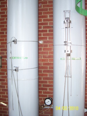

Figure 1. Portable meter uses fixed-frequency clamp-on transducers.

I think it's safe to say that ultrasonic flow meters finally have achieved their potential. I have taken more than 600 readings -- including on pipes containing acids, water, gases, and slurries at several hundred degrees -- with this portable meter and my success rate is 99.8%. (The lead photo shows me checking a 42-in-dia. line.) At the end of the day, I collect all the data dumps from the built-in data logger and export them to a spreadsheet.

We currently have five ultrasonic meters in our group -- four Fluxus F601 liquid units and one Fluxus G601 gas unit (Figure 1), which actually can measure liquids as well. Most applications we have are for liquid measurements but with a plant this size the ability to measure gas flows from outside the pipe is definitely a plus. The G601's specifications give a 100-psi minimum requirement to measure gas flows. The lowest-pressure line I've personally attempted to measure is 140 psi; that particular application was for a nitrogen header and the meter worked well.
