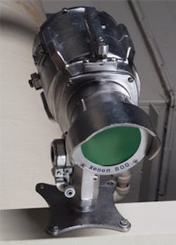

Gas detection system functions in range of climates
The SafEye Xenon 800 Gas Detection System detects a wide range of hydrocarbons over an open path of up to 120 meters. Resistant to false alarms and poisoning, it said to operate well in an extremely wide range of climates. A unique combination of triple optics and dual-spectrum sensor allows the system to maintain operational integrity in up to 90% signal obscuration.
MSA, (877) MSA-INST, www.msanorthamerica.com
