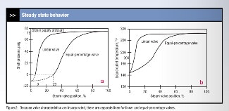

Consider the exchanger with its control valve on the steam supply. The condensate is discharged through a steam trap into the condensate return system. The liquid is a hydrocarbon fluid that enters at 150°F. The steam supply pressure is 75 psig. Under normal operating conditions, the liquid flow rate is 1,000 lb/min; however, occasionally liquid flow rates up to 4,000 lb/min are experienced. Consequently, the control valve must be oversized for the requirements of normal operating conditions. Of course, further oversizing is the norm. For this example, the control valve is oversized by about a factor of four (relative to what’s required for normal operating conditions).
A common misconception is that every control issue pertains to some aspect of process dynamics. In practice, many if not most of the problems with the controls have their root in the steady state behavior of the process.
The steady state behavior of the exchanger can be understood from the graphs in. Presents the shell pressure as a function of the steam valve position. Figure 2b shows the liquid outlet temperature as a function of the steam valve position — this is the process operating line for the exchanger. The term “process” is somewhat of a misnomer because the valve characteristics (valve size, inherent valve characteristics, etc.) also are incorporated into the operating line. This is why there are two lines, one for a linear valve and one for an equal-percentage valve.

The maximum possible control valve opening is always 100%. This gives the maximum shell pressure, the maximum heat transfer rate and the maximum liquid outlet temperature. Increasing the steam valve opening always increases these three variables. But for large valve openings, the increase will be very small — so small, in fact, that it’s practically zero. Once the shell pressure approaches the steam supply pressure (75 psig), the exchanger approaches the heat transfer limit and is said to be “maxed out.”
For heat transfer processes, the control valve normally is effective up to about 90% of the maximum heat transfer rate. For a constant liquid flow and liquid inlet temperature, the heat transfer rate is proportional to the liquid temperature rise from inlet to outlet. If the shell pressure is equal to the steam supply pressure, the shell steam temperature is 288°F. The maximum possible increase in liquid temperature is from 150°F to 288°F or 138°F. The control valve should be effective for temperature increases of 90% of 138°F or 124°F. This corresponds to a liquid outlet temperature of 274°F.
Figure 3 indicates the valve openings for a liquid outlet temperature of 274°F. For an equal-percentage valve, this is a valve opening of 50% (actually 51%, but let’s round valve openings to the nearest 5%). For a linear valve, this is a valve opening of 15%! This is typical for oversized valves with linear characteristics. If you install a linear valve, it must be properly sized for the process operating conditions.

Let’s assume that the condensate from the steam trap flows into a drain. Figure 2a indicates that the shell pressure is below atmospheric when the steam valve position is less than 29% for the equal-percentage valve or 6% for the linear valve. Under these conditions, the condensate won’t flow out of the shell. If the condensate flows into a condensate return system, the minimum shell pressure is approximately atmospheric pressure.
This imposes a minimum heat transfer rate on the exchanger. Atmospheric pressure in the shell corresponds to a shell temperature of 212°F. Because the liquid enters at 150°F, heat will be transferred to the liquid. This heat transfer rate is the minimum that can be continuously sustained by the exchanger in Figure 1. The minimum heat transfer rate gives a liquid outlet temperature of approximately 200°F, regardless of the valve characteristics.
Figure 4 illustrates the effect on the process operating lines. The minimum heat transfer rate corresponds to an opening of 29% for the equal-percentage valve and 6% for the linear valve.
