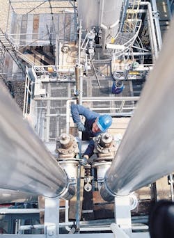

Involving the operator
Operators can play a pivotal part in proactive maintenance strategies and boosting pump uptime — by serving as the “eyes and ears” in a plant to detect equipment faults before problems can escalate.
Under Operator Driven Reliability (ODR), the operators perform basic maintenance activities above and beyond their classic duties (Figure 3). ODR enlists operators to observe and record the overall health of pumps by checking for leaks, listening for noises, monitoring temperature, lubrication and vibration, and taking responsibility to identify any abnormal equipment conditions — and, in some cases, to respond with the appropriate corrective actions. Hand-held technology allows operators to translate early detection of developing problems into prompt corrective action.
Figure 3. Operators can serve as a plant’s eyes and ears to detect developing problems.
