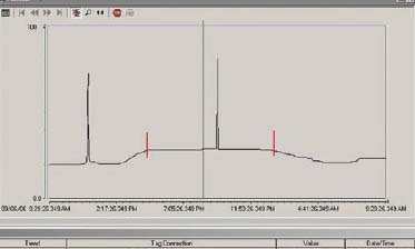

    Motors typically draw six to 10 times their rated current when they are started. A high current causes the windings to heat up, eventually leading to degradation. It’s necessary to limit the number of motor starts. An effective predictive maintenance strategy will ensure that the number of hot starts is limited to protect the motor winding.
    A smart MCC allows trending and alarms for detecting this problem. In Figure 2, the large amplitude spikes indicate when the motor was started. The area on the motor trend marked by the red lines shows a 25% jump in motor consumption. This increase is either an unusual process condition or a problem with the motor.
    Figure 2. Motor trend data can be archived in a DCS permitting evaluation of starting characteristics and other behaviors and how they relate to production.
