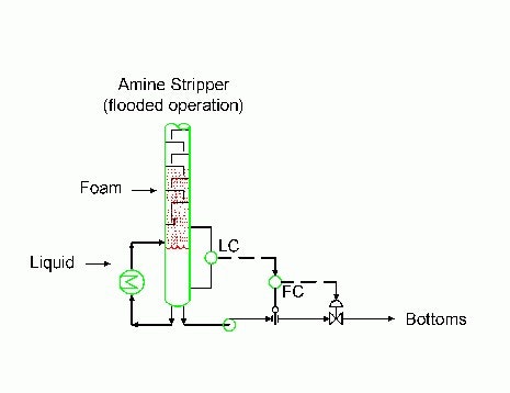

Foaming systems are particularly difficult for accurate liquid-level measurement because foam has a lower density than the foam-free liquid. In an amine stripper, foam caused the tower to flood (Figure 1). This plant lost an overhead accumulator full of liquid at least once and often twice per week. Foam entrainment forced the column to operate at lower capacity or product purities.
Flooded tower
Figure 1. Foam caused frequent operating problems and lead to a cutback in column capacity.
