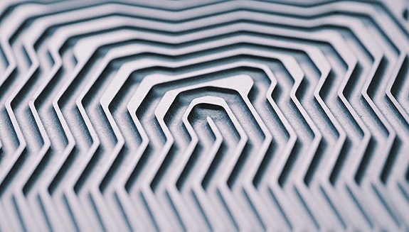

Printed circuit heat exchangers (PCHE) are a relatively recent option for process heat transfer. They get their name from the chemical milling procedure used in their manufacture, which is the same process employed for printed circuit boards. Introduced into the market beginning in the late 1980s, these compact exchangers feature flat metal sheets with flow channels chemically etched into them. The plates then are stacked and diffusion bonded to form a solid metal block containing precisely engineered flow passages. The channels typically are 2-mm semicircular in cross section. The small channel size fosters exchanger compactness.
Fluids can move in parallel-, counter-, cross-flow, or a combination of these to suit the requirements of the particular service. The operating temperature and pressure drop constraints for the given duty govern the required configuration of the channels on the plates for each fluid set. The channels can be of unlimited variety and complexity.

Many modern PCHEs feature zigzag flow channels. These zigzag flow paths do not allow boundary layer growth and encourage turbulent flow. By enhancing heat transfer area and increasing local flow velocity at channel bending points, the zigzag channel shape improves heat transfer performance compared to exchangers with straight or other simple pattern channels. Wavy geometries such as zigzag ones provide little advantage at low Reynolds numbers; maximum advantage is at transitional Reynolds numbers. For higher Reynolds numbers, the free shear layer becomes unstable; vortices roll up, thus enhancing heat transfer. At high Reynolds numbers, periodic shedding of transverse vortices and other effects raises the Nusselt number with a considerable increase in the friction factor. Some experts have suggested double-faced configuration. However, this is very difficult to implement due to plate alignment, especially when considering large plates on a tall stack — particularly if the flow paths are complex.
S-shaped patterns offer another option. The Nusselt number of PCHEs with zigzag patterns is 25–35% higher than those with S-shaped patterns — but the pressure-drop is about 2.5–5 times larger, depending on Reynolds number. Properly optimized S-shaped models theoretically decrease pressure drop to 25–35% of that of conventional zigzag models while reducing heat transfer performance only slightly. They particularly would suit applications with pressure-drop constraints. However, S-shaped PCHEs need much more expensive etching and challenges exist for proper diffusion bonds.
