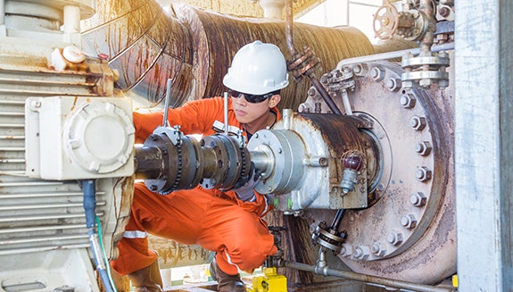

Misalignment. If a driver connects to driven equipment by any form of coupling, there’s a risk of parallel and angular misalignment. This will cause vibration at both 1× and 2× rotational speed in both radial and axial directions. The force generated by the misalignment can deform sensitive parts and components such as the bearing housing, seal cartridge, etc., in the driver or driven equipment. A distorted bearing housing can result in bearings that are out of line. For machines with rolling-element bearings, the additional loads and forces can reduce bearing life to 25% or 20% (or even less) of the original expected life. Many cases of rolling-element bearing failures have been traced back to the misalignment.
