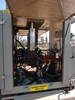

Gas Engine
Figure 1. This engine is located in a utility area of a plant.
