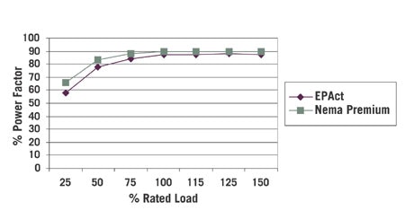

Figure 3. Power Factor Penalties At Reduced Loads
As motor load drops below 75 percent, the power factor falls off precipitously.

Operation of the motor at a slightly lighter load does not compromise efficiency, but the power factor is lower (Fig. 2 and 3). If the motor operates at 50 percent of full load, both power factor and efficiency drop off. For best performance and efficiency, motors should be sized for the load. Avoid continuous operation in the motor's service factor load range, which is meant to accomodate short-term overloads ," not continuous operation.
