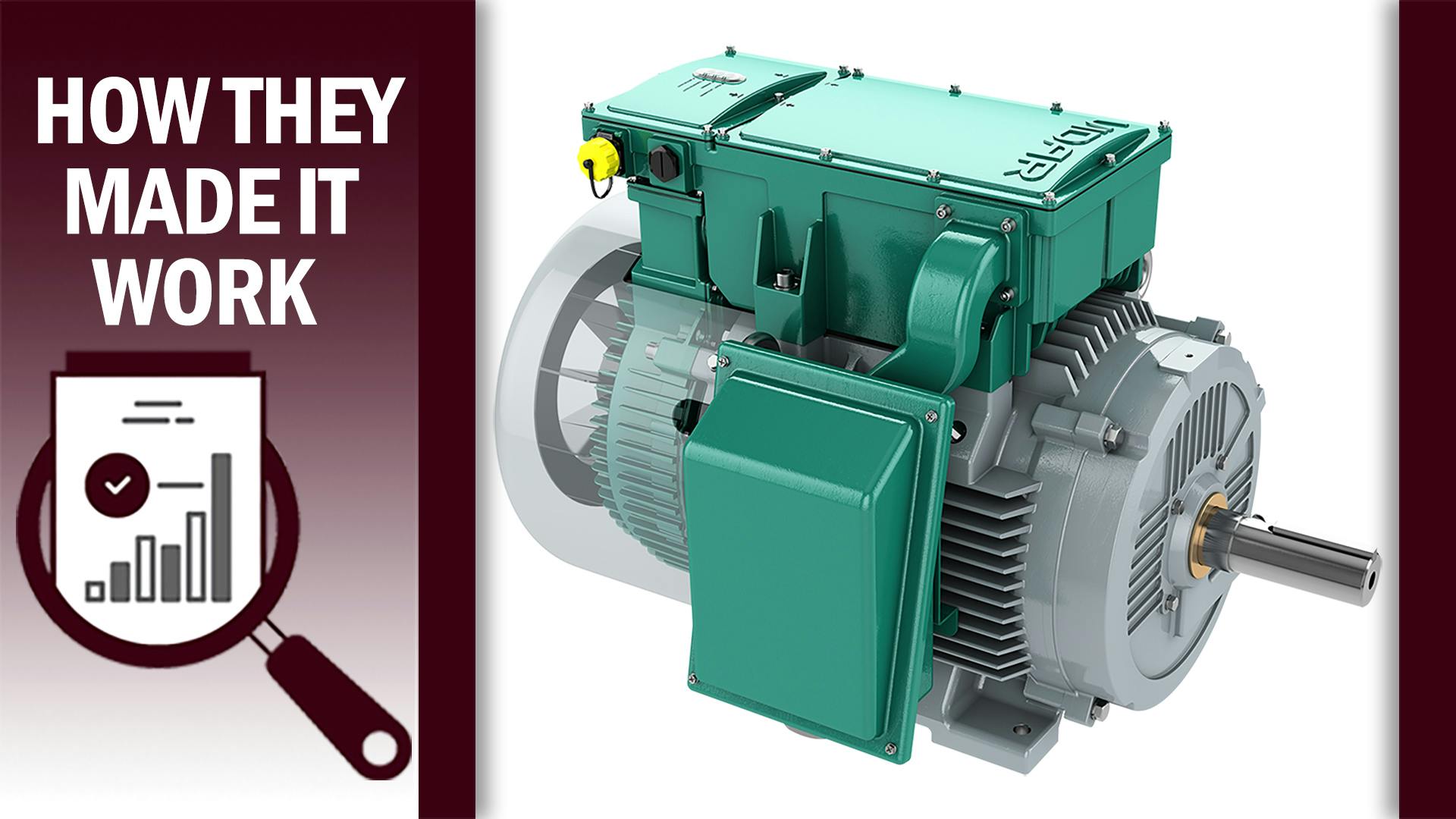

VIDAR is a new type of motor that embeds variable-speed intelligence directly into the motor with the potential to deliver reduce costs and energy consumption, while extending the life of industrial pumps, fans and fluid process systems.

VIDAR embeds variable-speed intelligence directly into the motor using patented AC-link technology that replaces conventional AC-to-DC-to-AC VFD technology while installing seamlessly into an existing industrial fluid delivery system. It eliminates the need for mechanical controls, providing a more efficient, easier-to-maintain industrial solution.

Space Savings: VIDAR combines the motor and VFD while removing the DC stage from AC-to-DC-to-AC VFD technology using a patented AC-link approach. This shrinks the VFD by 60% and eliminates bulky capacitors without requiring additional enclosures or extra space.

The motor is compact and completely integrated and utilizes a high-efficiency synchronous reluctance magnet-assisted design using IEEE-841 specifications. It also meets CSA Class 1 Division 2 for hazardous areas and meets IEEE-519 power quality standards. It offers 10%-15% cooler temperatures than induction motors and ultra-low harmonics for the safety and convenience of operators.
