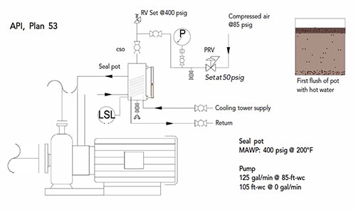

Our pumps use API Plan 53 for sealing. We’re having problems with our seal pots: high consumption of very expensive oil, and contamination of the oil in the pot (see Figure 1).
Seal Pot Problem
Figure 1. High oil consumption as well as contamination afflict operation.
Our young inspector brought this to my attention. He wants to bring in the pump salesperson but I doubt that person has the technical expertise we need. I can’t get any help at all from the company that sold us the seal pot or the seals; the salesman familiar with our product suggested a steam seal but that’s not our corporate policy. We have trouble maintaining pressure at our air compressors, especially with the use of pneumatic pumps all over the plant. I have seen the psi at the air tank drop to the low 70s; the tank is located 500-ft away from the seal pot. I want to send the sample to a laboratory for analysis because I think it’s the seal.
The inspector wants to test the cooling water coil. He thinks it might be leaking into the seal pot. The water is from a cooling tower.
What is the cause of the high consumption of oil? Is there any solution besides continuing to go through $10/gal oil? Are there any tests we should run?
