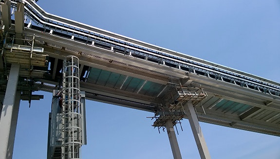

Belt conveyors transfer many types of solids at chemical plants. A typical belt conveyor consists of many bits and pieces that should work together in harmony. The behavior of the belt and other parts are complex. So, unsurprisingly, operational and reliability concerns can arise.
The interactions with upstream and downstream units, e.g., a conveyor feeding it or equipment getting solids from it, are important, and can impact the operation and configuration of the conveyor(s).
The belt tension is a key operating parameter. Belt loading, thermal movement and dynamic tension waves (during starting, stopping, etc.) cause variations in belt tension. So, a take-up system is needed to control the belt tension. The configuration of the take-up system and related key parameters (minimum tension, belt sag, etc.) require great care.
This article provides practical guidelines and useful tips on the operation of belt conveyors and issues that might occur.
