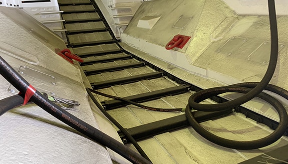

Many chemical makers overlook chain conveyors. That’s not surprising because published information on them is sparse. Yet, these strong and rugged conveyors ideally suit applications such as special feeding units that call for slower transportation speeds over short distances and at moderate inclines. The angle of incline can exceed that usually used for belt or other conventional conveyors — even steep and varying angles are possible. Chain conveyors generally operate at relatively high discharge rates in applications that need great flexibility and pose load variations.
The devices usually have a lower profile and lighter design than other conveyors and, thus, offer benefits in applications with limited space or requiring a compact/low-weight unit. Moreover, chain conveyors often operate better with sticky materials and in challenging services than other conveyors such as rubber belts (which tend to retain sticky materials that even multiple cleaning stations might not effectively remove).
A chain conveyor consists of a trough or bed (bottom of the conveyor casing) on which run continuously driven chain(s) with pendants, flights or attachments. These pendants, flights or attachments scrape the bulk material over the trough, moving solids forward to the discharge point. The chain is driven via sprockets (wheel teeth).
The chain is specifically designed for conveyor service. It usually consists of a series of journal bearings held together by link plates or something similar. Many design alternatives exist. In a popular one, each bearing comprises a pin and a bush on which the chain roller revolves. Commonly, drop-forged chain, also known as scraper chain, is used. Other options include hollow-bearing-pin, solid-bearing-pin, deep-link, forked, round-link and box-scraper chain.

In many configurations, the chain is installed and moved on a conveyor trough (deck or bed — Figure 1); this trough/surface is prone to wear by both the chain and the bulk materials handled. The wear mainly concentrates around the chain unless delivered materials are significantly abrasive. Wear of the accelerating area is more serious than that of the stable (constant speed) area.
