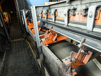

Technicians first installed three impact cradles on both 19A and 19B, located under the belt in the loading zones (Figure 2). The cradle design features a bed of steel angles lined by energy-absorbing impact bars with a top layer of low-friction ultra-high-molecular-weight plastic. The impact beds absorb the energy, so the belt doesn’t have to. They also create a flat edge for the edge seal, to prevent spillage and fugitive dust. The cradles feature wing supports that adjust to match Conveyor Equipment Manufacturers Association standard trough angles, as well as provide a 5% fine tuning. This allows the cradles to accommodate the idler profiles of different manufacturers and ensure a tight belt seal.
After the impact zone, a series of 16 slider cradles were installed on each conveyor to stabilize the belt line and eliminate bounce. Transfer points can be prone to spillage as the load lands on the receiving conveyor. Once the belt leaves the impact cradle, it also can sag while the material is still settling. This compromises the skirt seal, allowing dust and fines to escape while creating entrapment points where material can get caught and gouge the belt.
The slider cradles are designed for conveyor systems with speeds up to 700 ft/min and belt lengths of more than 50 feet. Typically 48-in. long, the units also are available in custom sizes. The proprietary box design allows flipping each bar over at the end of its useful life to provide a second wear surface. The result is a flat and stable belt surface throughout the settling zone, reducing fugitive material and extending belt life.

Figure 2. Installed in the loading zones on each conveyor, these create a flat edge for improved containment.
