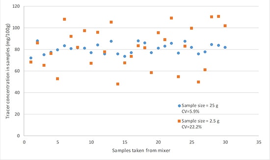

As a consequence, discussing the homogeneity of a mix of solids demands care. The nature of the solids being mixed and the sample size significantly affect the confidence you should place in any measurement of homogeneity. Sample size is a critical parameter (Figure 1). So, always reflect upon what represents a meaningful sample size for an application; selecting too small a size will make it difficult to determine if the mix is homogeneous, while too large a size almost certainly will make the mix appear homogeneous. For example, if a mixture is intended to be consumed (such as a pharmaceutical or food), the appropriate sample size is the serving size.
Influence Of Sample Size
Figure 1. Reducing sample size from the recommended size (25 g) increases the variance of concentration between samples and results in a higher CV.

The analysis is performed on a tracer, a component of the mixture whose distribution is taken as representative of the state of the mixture. Getting meaningful results, i.e., rather narrow confidence intervals, generally requires a minimum of 30 samples from the mix, with a sampling methodology that doesn’t leave part of the mix unsampled.
