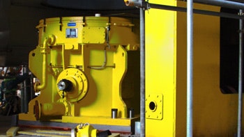

Bowl Mill
Figure 1. A compression mechanism such as a spring applies pressure to rollers to perform grinding.

A bowl mill (Figure 1) is similar; it also relies on multiple rollers (tires in some applications) to crush materials. Two common variants are high-speed and medium-speed bowl mills. In high-speed units, the planetary gearbox used to increase the speed is especially critical. Selection, installation, operation and maintenance of such a gearbox demands great care. It should be rugged and reliable, and also easily removable for maintenance. A sealing arrangement is necessary to prevent entry of dust-laden air into the gearbox. Many unscheduled shutdowns or failures stem from bearing issues or oil-related problems. Thrust bearings deserve particular attention because they usually are vulnerable and limited in capacity, and often have relatively low margins and safety factors. The surface of the bowl should be lined properly with suitable wear-resistant materials.
A common mill design employs three grinding roll assemblies; these often use tapered roller bearings. Stop bolts support the system and allow adjustment of the clearance between roller and bowl. Compression springs or another compression mechanism mounted above the roller assembly apply pressure for grinding. An internal multivaned classifier with externally adjustable vanes is connected to the mill discharge.
Materials enter the center of the bowl through an inlet chute; centrifugal force pushes the materials towards the periphery. Meanwhile, the rolls exert the required grinding pressure. The primary air supplied to the mill side moves up through the vanes around the bowl. The air is directed toward the center of the mill, causing recirculation through the grinding area of materials rejected by the classifier. The air lifts the fine materials and moves them to the classifier through the vanes.
