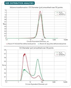

Size Distribution Analyses
Figure 1. Volume-based particle-size-distribution data (upper graph) suggest two materials are similar but number-based distribution (lower graph) shows a much higher level of fines in the W/Ni/Fe sample.

1. Optimizing the properties of ceramic granules. Most ceramic products, from bowls to intricate electronic components, are made by pressing ceramic powders into a mold and then firing the resulting “green body” to produce a finished, sintered component. Spray drying is used to convert ceramic slurries into granules that will perform well in this process. Finer powders pack densely in the mold, thereby reducing shrinkage when the component is fired, which is a positive feature. However, they also tend to exhibit poor flowability and are prone to segregation, which can be a problem for multicomponent ceramic mixtures incorporating additives. Spray drying pre-blended slurry avoids this latter issue. Particle size and shape also influence the mechanical properties of the green body and the fluidity and malleability of the final product. Establishing correlations between size and shape parameters supports the manufacture of higher quality ceramics.
Two ceramic test samples were prepared using a spray dryer: one made from Al2O3, the other from W/Ni/Fe. The two samples were produced nominally to the same particle size under identical spray drying conditions, and subsequently were analyzed by the Morphologi G3 using a standard operating procedure and automated sample dispersion unit. Number-based particle size and shape distributions were generated for both samples, with shape data generated only for those particles with a CED > 10 µm, to conduct a shape comparison on particles of the same size.
Figure 1 shows volume- and number-based particle size distributions for both samples. The volume-based size distribution suggests the samples are closely similar, but the greater sensitivity to fines of the number-based distribution indicates higher levels of material in the sub-10-µm region in the W/Ni/Fe sample: 79.2% for the W/Ni/Fe sample compared with an equivalent figure of 37.6% for the Al2O3.
Circularity data for the two samples (Figure 2) reveal the Al2O3 sample contains more circular particles than the W/Ni/Fe sample. Images of particles from both samples confirm the data and show the W/Ni/Fe particles to be both smaller and less regular.
These results suggest that, despite consistent spray drying conditions, the finished powders have different particle morphology. While further studies are required to fully explain the reasons for this, factors such as the properties of the feed slurry, its viscosity, composition or interfacial characteristics may well contribute to the observed differences. From the perspective of product performance, the Al2O3 sample would exhibit greater flowability when used to manufacture ceramic materials compared with the W/Ni/Fe alternative, and produce a finished component of higher malleability.
