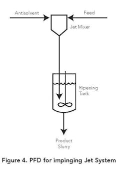

Impinging Jet System
Figure 4. Product ripening in stirred tank fosters diffusion of trapped mother liquor in the nucleated solids.

In-line mixing equipment for crystallization includes impinging jets, vortex mixers, Y mixers and rotor-stator configurations. The antisolvent and product solution (which may contain seeds) are mixed in a very small active volume; this yields extremely high supersaturation values that are above the MZ, resulting in the production of a large number of nuclei. The two streams are mixed at the molecular level with excellent micromixing, with mixing times often being less than the nucleation induction time. Good control of nucleation can be achieved in the intensely mixed volume.
Impinging jets have high shear and high energy inputs in a small region and rapid localized intense mixing of the streams. A jet mixer can generate local energy dissipation rates ten times greater than those achieved in a stirred vessel.
Scaleup to commercial production from the laboratory or pilot plant often is feasible. Naturally, downstream recovery presents problems in terms of filtration, washing and drying.
Figure 4 depicts a flow diagram for one type of impinging jet configuration. In this case the product is ripened in a stirred tank following contact of the product and antisolvent streams in the jet mixer. The ripening can be batch or continuous and is designed to facilitate diffusion of the trapped mother liquor in the nucleated solids. Adequate ripening time also is provided to convert amorphous solids into crystalline structures. In some applications seeds are added to the antisolvent stream or the ripening vessel.
