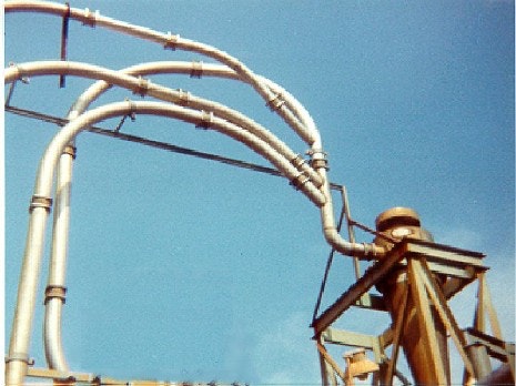

  • Put lifts before horizontal runs. In most conveyors the feed point has the lowest gas velocity and particles may fall out of suspension. This can be offset by line size changes but standard line sizes can force you to push the velocity higher than desired, especially near the end of the line. As the pressure along the line goes down, the velocity goes up. By raising the conveyor in front of horizontal runs instead of at the end, particles have a chance to accelerate toward the gas velocity and gain momentum, mainly because the choking velocity is generally lower than the saltation velocity. The downside is cost. Unless you are going over a building, the extra support can be expensive.
  • Minimize elbows and angled runs. Pressure drop and attrition are highest in elbows (for the effective distance solids travel). Most of the wear and maintenance seen in pneumatic conveyors is due to the elbows; so it often is best not to use too many. The major exception to minimizing the number of elbows in a system is for a line that needs to go up and then horizontal. While an angled run offers the shortest distance between two points, it does not have lowest pressure drop. Indeed, a convey line going up at a 45° angle has much higher pressure drop than a horizontal and vertical line with three elbows. Putting elbows too close together is another major mistake, due to acceleration effects. Many models just count the amount of elbows — but placement in the layout is more important. The lowest number of elbows is not always optimum.

    Figure 1. Sometimes no detailed analysis is needed to spot a bad layout.
