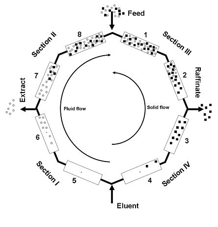

SMB is a chromatographic technique based on a flow of liquid (mobile phase) moving countercurrent to a constant flow of solid (stationary phase). Countercurrent flow enhances the potential for the separation and, hence, makes the process more efficient. It also allows a continuous flow of feed material to be separated, which improves the throughput of the equipment compared to traditional batch chromatography.
Providing a constant flow of solid is impractical in a production process. Therefore, the solid instead is packed into high pressure columns. These columns are arranged in a ring formation made up of four sections with one or more columns per section (see Figure 1). Two inlet streams (feed and eluent) and two outlets streams (extract and raffinate) are directed in alternating order to and from the column ring. Because the columns cannot be moved, the inlet and outlet position is switched at regular time intervals in the direction of the liquid flow, thus simulating countercurrent movement of columns.
Figure 1
The flow rates in Sections II and III are important because this is where the separation occurs. Sections I and IV handle “cleaning.” Mobile phase exiting Section IV is directly recycled to section I. The solid is regenerated there by desorbing the more retained compound with a high flow rate so the complete column can be “moved” into section IV.
