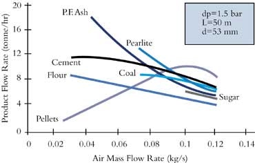

    Keep in mind that a system that conveys one product well may be completely unable to convey another product. Minimum conveying air velocities differ from product to product, and air leakage across feeding devices is also product dependent. If a system has to convey more than one product, this requirement must be considered carefully at the design stage. Fig. 2 plots product flow rate against air flow rate for a range of products.
    Figure 2. Product Influences Performance
    The flow rates of various products in a 53-mm-diameter piping system, 50 m long with nine 90 elbows, show wide differences in required air mass flow rates.
