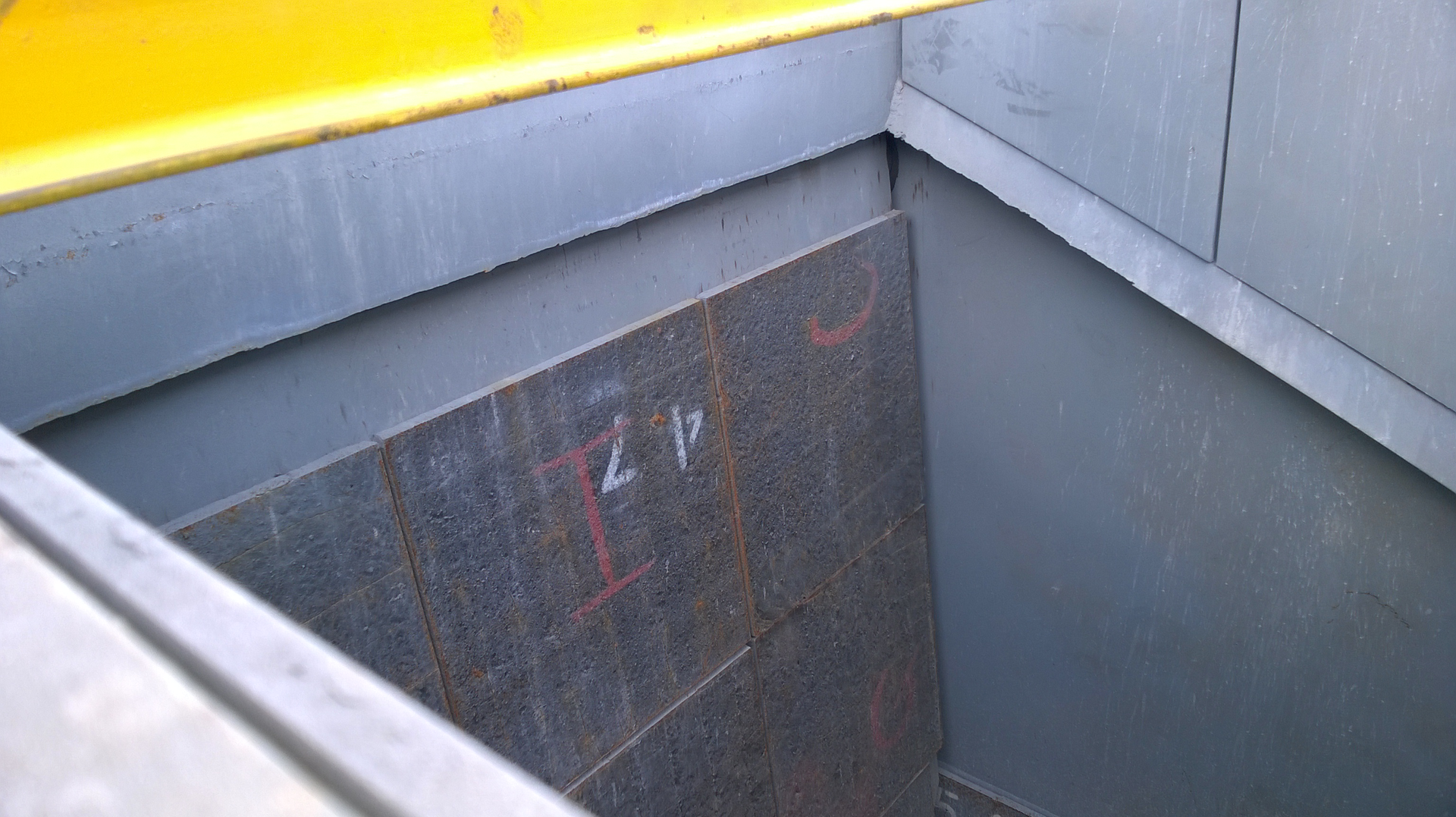

Examples of wear resistance tiles inside a chute for bulk material handling. In this chute, only the surface under direct impact of the discharge bulk materials is protected with tiles.
