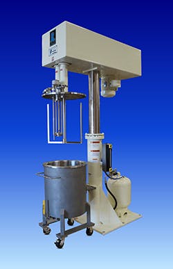

Ross incorporates a high shear rotor/stator into a dual-shaft mixer designed for more intense shearing and homogenization requirements. Instead of a conventional high-speed disperser blade, the rotor and slotted stator mixing head – also often called a homogenizer – affords more advanced deagglomeration and emulsification capabilities. Complementing the high shear mixer, a two-wing anchor promotes bulk flow and uniform batch temperature. The pictured Ross Model CDA-25 features dry-running Double FlexiLip seals on both agitator shafts suitable for vacuum operation up to 29.5” hg and includes a portable mixing vessel with heating/cooling jacket.
