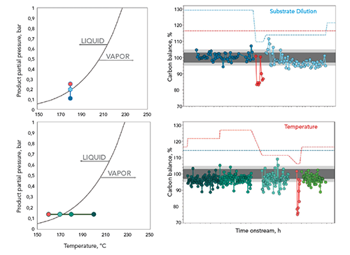

Impact Of Operating Conditions
Figure 1. Graphs show carbon balance for different feed dilution ratios and reactor temperatures in comparison to the phase diagram of butanediol as the high-boiling product.
hte supported Sipchem’s experimental program and the objectives of the study to test the impact of process conditions while still considering individual catalyst effects. The sophisticated reactor filling concept enables conducting several experiments in parallel. Here, these involved 1) residence times variation (achieved by loading different catalyst masses); 2) testing of spatial catalyst arrangements; 3) changes in the mass ratio of guard to conversion bed; and 4) duplicate positions to verify the rig performance and data quality. hte uses a fully integrated digital laboratory workflow based on proprietary software. Its myhte relational database combines all available catalyst and reaction data to allow advanced structure performance evaluations.

The multistep hydrogenation of DMM to BDO is an exothermal reaction that proceeds with volume contraction. High pressure and low temperature thermodynamically favor high product yields. However, the desired parameter space resides fairly close to the dew point line of the main product and needs improved catalyst design on the one hand but very precise process control on the other hand to avoid condensation inside the pores of the catalyst.
Figure 1 shows how temperature and feed dilution were decreased until the dew point line was touched to verify the catalyst performance at this desired sweet spot. Precise control of temperature and partial pressure allowed the recording of data close to phase transition. Fluctuation of the mass balance increased near the expected condensation point of BDO. Beyond this critical condition, the carbon balance dropped significantly and liquids were recovered in the safety condenser. The results do not suggest a superimposed condensation based on catalyst pore effects, which is a desirable ability for these kinds of catalysts.
