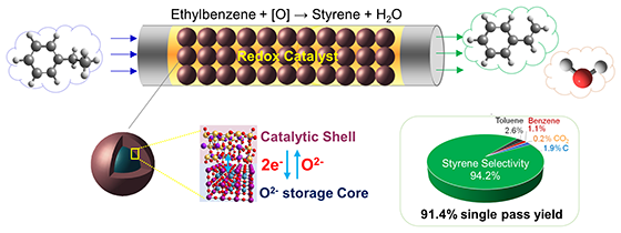

Redox Catalyst
Figure 1. Researchers develop a redox-oxidative dehydrogenation scheme that converts ethylbenzene to styrene using a tailored multi-functional redox catalyst. Source: Nature Communication.
The conversion process temperature is similar to traditional methods at 500–600 °C, however, the redox-ODH process requires no steam for a reaction to take place.
