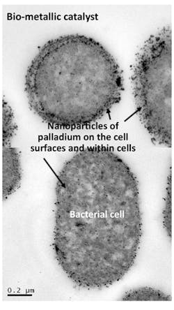

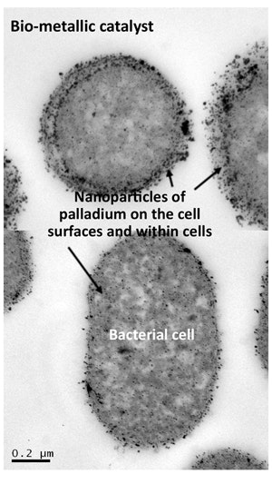

Catalyst Closeup
This photomicrograph shows the palladium and bacteria catalyst. Source: Lynne Macaskie.
Previous studies have shown that bio-oil flowing through porous carbon particles infused with palladium is effective. However, those carbon particles are not cheap, notes Illinois Sustainability Technology Center researcher B.K. Sharma, who led the research.
“Instead of using commercially produced carbon particles, we can use bacteria cell masses as a sort of biologic scaffolding for the palladium to hold onto,” Sharma explains. “The oil can flow through the palladium-decorated bacteria masses as it does through the carbon particles.”
“We found our product [called bio-Pd/C] to be as good or even slightly better [than commercially produced catalyst],” he notes. “We were able to remove the oxygen and nitrogen impurities at a comparable rate, and yielded the same volume of product using our cheaper, greener catalyst as is observed using the more expensive commercial catalyst,”
