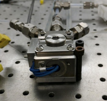

Figure 1. Laboratory reactor uses UV light to make methane with very high selectivity. Source: Duke University.

The UV-light-driven catalysis of CO2 boasts 98% selectivity to methane, in contrast to conventional catalytic processes that yield methane with about equal amounts of carbon monoxide and other side products, the researchers note.

“Our greatest remaining challenge is to ascertain how best to exploit the advantages of illuminated rhodium catalysts. We’ve shown that light highly selects methane over carbon monoxide, but we don’t yet know how much faster the reaction can go and how this advantage can be adapted for large-scale production. Designing the right reactor that can incorporate light is another challenge,” he explains. “We need help to design a reactor that can incorporate light sources and can also be used at high temperature.”
