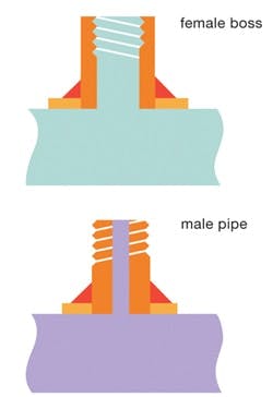

THREADED TAP NOZZLES
Figure 2. These nozzles feature either a female threaded boss or male threaded pipe nipple to connect the process line to the sampling system.

The simplest way to construct a nozzle is to weld a female threaded boss to a pipeline and drill it through (Figure 2). First, weld a reinforcing plate to the pipeline, unless its wall is adequately thick. Next, select a boss size to accommodate the threaded probe or valve being used. Another approach is to weld a male threaded pipe nipple onto the line (Figure 2).

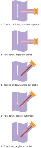

VERTICAL GAS LINE
Figure 4. Tap orientations and probe end designs vary depending upon process sample conditions.
Of course, neither of these simple methods will satisfy a process piping specification that prohibits threaded joints at the process envelope. Facing these constraints, you can weld a valve onto the nipple or use a flanged pipe nozzle instead.

If the process gas is clean and dry, you could locate a gas nozzle on the side of a horizontal pipe. However, avoid such a horizontal probe orientation for dirty samples because the gas flow in the probe may not be turbulent; solid particles could fall out and block the probe
The same concern for blockage applies to a horizontal nozzle on a vertical gas pipeline (Figure 4). The inclined nozzles also shown in Figure 4 allow any entrained liquids or solids to fall back into the process. This feature works well for liquid removal but may not for solids, which may stick in the probe
For vertical stacks, the nozzle should be horizontal or slightly inclined and much larger — sized to accommodate special probes. Here, nozzle location is based on the gas temperature: not too hot (so material costs are reasonable) but above the acid dew point temperature (so sulfuric acid doesn’t condense in the probe). For stack gas monitoring, the optimum gas temperature at the nozzle is a little more than 600°C (1,112°F) to ensure complete combustion.
