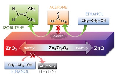

The catalyst consists of nanosized ZnxZryOz mixed oxides. It spurs ethanol dehydrogenation to acetaldehyde, its conversion to acetone, and then an acetone-to-isobutene reaction, while suppressing ethanol dehydration and acetone polymerization and coking — giving isobutene yields as high as 83%, report the researchers in a recent article in the Journal of the American Chemical Society.

Figure 1. Proper balance of zinc and zirconium oxides spurs production of isobutene while minimizing unwanted byproducts. Source: Pacific Northwest National Laboratory.
The catalyst requires water, so raw bio-ethanol possibly can go directly to the reactor. However, impurities in the fermentation broth might poison the catalyst and so might have to be removed. "But this shouldn't be a showstopper since purification technologies exist," he says. "Potential deactivation by coke formation is a concern. But that's not a showstopper since catalyst life is already demonstrated at >20 hours time on stream, and even without further improvement, it can be operated with a conventional swing-bed operation (one [catalyst bed] under operation and another one under regeneration to provide continuous operation)."
