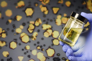

Figure 1 Container holds gold/solvent solution while screen shows gold recovered from the solution by calcination. Source: Georgia Institute of Technology.
