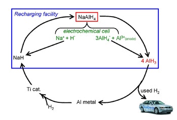

Figure 1. Vehicle gets hydrogen from alane, which when spent is regenerated electrochemically. Source: Savannah River National Laboratory.
The process uses electrolysis and catalytic hydrogenation of spent aluminum to produce alane at ambient conditions (Figure 1). The electrolysis reaction takes place in a polar solvent such as tetrahydrofuran, while commercial titanium catalyst speeds the hydrogenation. The researchers describe the technique more fully in a recent paper in Chemical Communications.
So far, experiments have been conducted at bench scale (3–4 grams/run) in an inert atmosphere and have involved one regeneration cycle, says Zidan. The catalyst should last around 500 cycles, he believes.
