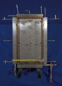

Velocys, Plain City, Ohio, uses microchannel technology to dramatically reduce heat and mass transport distances commonly found in conventional systems, thus increasing the rate of heat and mass transfer and, in turn, greatly accelerating reaction rates. Further, as the efficiency of converting feedstock material to products is strongly governed by the ability to control these chemical reactions — which depends upon the ability to control reaction temperature, which in turn is governed by the ability to move heat quickly — the technology often can increase product yield.
Velocys’ chemical processors feature parallel arrays of microchannels, with typical dimensions in the 0.010-in. to 0.200-in. range (Figure 6).
Figure 6. Microchannels permit use of much more active catalysts, which greatly boosts throughput.
This structure is said to allow use of much more active catalysts than conventional systems, greatly boosting the throughput per unit volume. A catalyst can be tethered to the reaction wall or coated inside the channels. Overall system volumes reportedly can be reduced by 10 to 100 fold compared to conventional hardware. Figure 7 shows a large-scale, prototype microchannel reactor that will begin operating in 2007.
Figure 7. Large-scale demonstration unit is slated for operation in the first quarter of 2007.
Some of the applications under development include:
  • hydrogen production using steam methane reforming;
  • high intensity oxidation and partial-oxidation reactions with improved process selectivity and yield;
  • high-performance emulsification processes; and
  • synthetic-fuel production and methanol synthesis in compact units suitable for land or offshore installation.
Steam reforming highlights the power of the approach. About 95% of the hydrogen produced today in the U.S. is made by reforming a methane source such as natural gas using high-temperature (700°C  to 1,000°C) steam. Refineries are major producers of hydrogen, using it primarily for their hydrotreaters and hydrocrackers. In the reforming process, methane endothermically reacts with steam under 3–25-bar pressure in the presence of a catalyst to produce hydrogen, carbon monoxide and a relatively small amount of carbon dioxide.
With the microchannel technology, hot combustion gases push the reaction forward, with the hot gases flowing in channel layers alternating with the reactor channel layers. The hydrogen is then purified in a pressure swing adsorption unit. Plant size is reduced by 90% compared to conventional reformers, and the approach boasts a 30% savings in capital cost, higher thermal efficiency and lower emissions, according to the company.
Scale-up is easily accomplished by adding more layers of channels. Once a plant is in operation, its capacity can be increased simply by installing additional layers of channels.

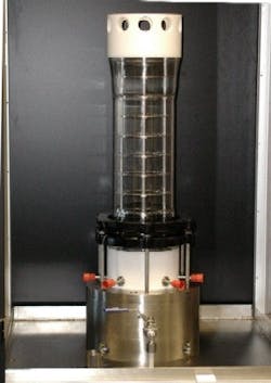

Cambridge Reactor Design, Cottenham, U.K., offers the Oscillating Flow Reactor, which takes advantage of the company’s Oscillating Flow Mixing (OFM) technology (Figure 8).
Figure 8. Baffle geometry coupled with intensity of oscillation produced by pistons control mixing behavior.
OFM combines fluid oscillations with baffle inserts to provide highly effective mixing in tube reactors. Mixing behavior is controlled dynamically by oscillation intensity or geometrically by baffle design. While the technology can be applied to batch operations, it is said to be particularly suited to continuous processing.
The standard reactor consists of an oscillator base and a reactor tube top section (Figure 9). A nutating cam mechanism driven by an electric motor and linear actuator controls the amplitude and frequency of operation. A pair of pistons driven off the two cams provides oscillations in an inverted “U” arrangement of reactor tubes. All of the variations are achieved by electronic control of the motors.
Figure 9. Standard design includes an oscillator base and a reactor tube top section.
Process tubes are added via top plate extensions, each of which takes two reactor tubes. In this manner, the unit can be operated as four-pass, six-pass, etc., as required to increase reactor volume or residence time.
Typical applications include biodiesel, suspension polymerizations and liquid/liquid dispersions.
