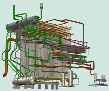

Figure 1.
Data-centric design
Along the way, improved data transmission technology and the Internet enabled design firms to distribute design work among multiple offices or between contractors who are sharing the overall design-construction process. This now is a fairly routine process. "With the right procedural controls in place, and sufficient data-trunkline capacity, it is straightforward to run a project from multiple locations," Bechtel's Choi says. A global organization like Bechtel can work on a project around the clock, "following the sun," as the expression goes, with an office in the United States handing off a project to an office in Asia at the end of the American day. Then the Asian operation, in turn, forwards it to a European office.
