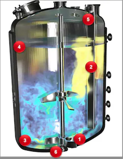

The areas inside a stirred reactor that are prone to friction and electrostatic charge buildup include (Figure 3):
  1. Tips of agitator blades
  2. The surface of the baffle
  3. Bottom brim
  4. Interface between the liquid level and the vessel wall
  5. Inlet of nozzles or baffles
  6. The bottom outlet nozzle from the reactor where the liquid swirls out under pressure
