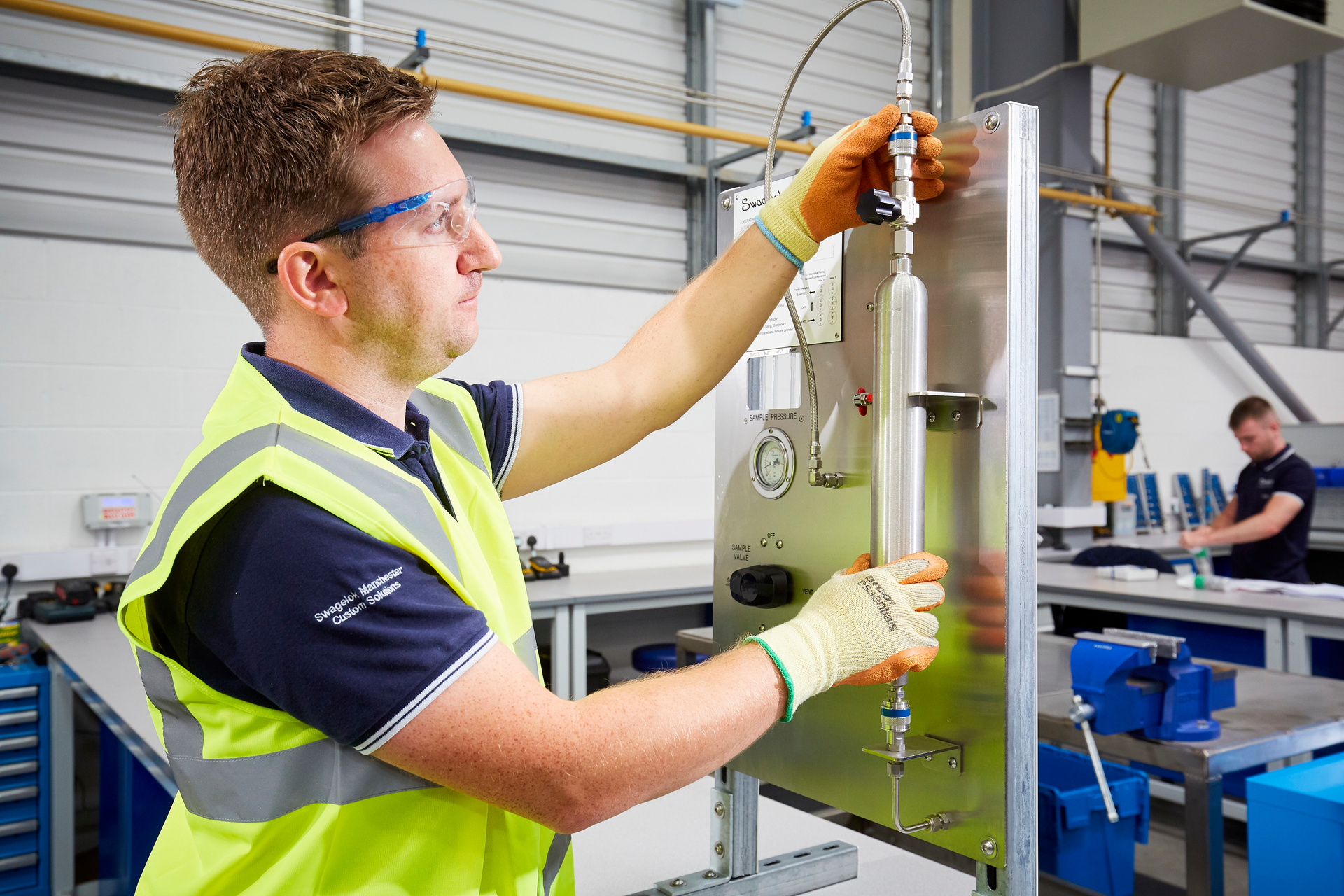

“Grab sampling” is an essential step for monitoring process conditions. It involves collecting a sample fluid in a pipeline, tank or system and then analyzing it to validate expected outcomes. If grab sampling takes place regularly, chemical processing plants need to keep their sample cylinders working safely and securely.
