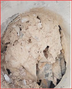

This first example involves a tower with a very deep bed (>25ft) of grid packing. The incoming feed stream contains a dissolved salt component. The salt will only precipitate if one of the chemicals from the feed mixture is stripped overhead. The primary objective of this tower is to remove salt from the solution and capture it using a filter on the bottoms stream to prevent fouling in downstream equipment.
As shown in the process diagram (Figure 1), the bottoms and distillate streams are recombined before feeding to the next tower. Most of the salts pass through the tower as intended, but some accumulate over time, leading to the eventual fouling.
Historically, the tower can only run for approximately three months before the fouling becomes too severe to operate. When this occurs, there are several signs indicating the column needs maintenance, most notably the column floods and massively entrains liquid into the overhead accumulator. Leading up to this event there were signs fouling was occurring, such as a steady increase in the column differential pressure over time, a loss in separation capability for the volatile solvent, and a temperature inversion within the packed bed.
Figure 2 shows the extent of the fouling, which is severe. This photo was taken from the manway at the bottom of the packed section. Fortunately, the salts are easy to wash away with water, as shown in Figure 3.
