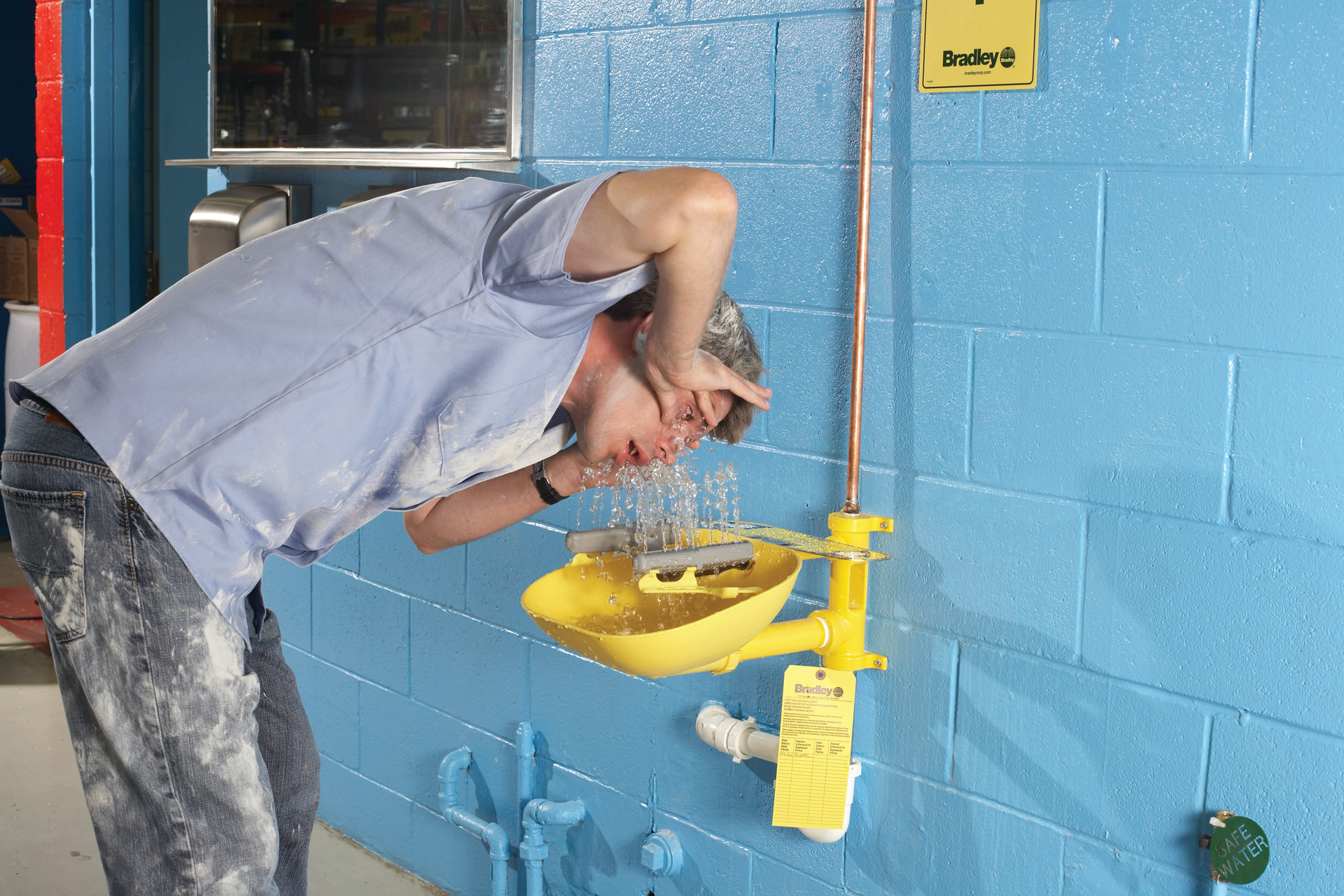

Source: Bradley
Figure 2. Emergency fixtures must be easy to locate in case of an emergency. Good lighting, brightly colored fixtures and signs can help users find eyewashes and drench showers easily.

It’s also important for safety fixtures to be clearly identifiable and easy to reach (Figure 2):
  • The area around the fixture should be well-lit.
  • Each fixture should be identified with a highly visible sign.
  • A drench shower or eyewash in a bright color like yellow is easiest to spot in a busy industrial environment.
  • Eyewash spray heads should be a minimum of 6 in. (5 cm) from walls or obstructions to allow the user clear access for eye flushing.
  • The area for flushing under the drench shower should be unobstructed. The only exception is the eyewash on a combination drench shower and eyewash fixture. In this case, the eyewash is placed in line with the drench shower to allow for simultaneous use.
