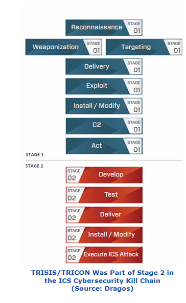

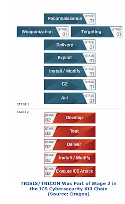

According to cyber-security vendor Dragos, which was also involved in addressing the attack, Triton was really a supporting attack on the ICS cyber security kill chain, which serves as part of a larger mosaic of attacks and intrusions to form a coordinated whole. In other words, this attack was part of a larger scheme. You can download the highly informative Dragos white paper on the attack here. In SANS Institute’s Mike Assante’s blog post, he points to Trisis as being in the “Supporting Attack” phase of stage 2 in the kill chain.

TRITON malware should be viewed as one element in the cyber kill chain and, in this case, it seems to be one aspect of a more coordinated attack. Unlike a virus or worm (like Stuxnet) that could be easily spread and propagated, the malware could only be successfully loaded if several conditions are present. TRITON does resemble Stuxnet in that it too was highly targeted not only at a specific facility, but to a specific model of a controller. And like Stuxnet, the TRITON attack was most likely conducted by a source with considerable resources to gather information about this specific installation and launch a highly specialized attack. This points to the possibility of a nation state-sponsored attack.
Cyber-security suppliers like Dragos use the term “tradecraft” to describe the common behaviors that attackers use to cause damage. The fact that the Triton/Trisis “tradecraft” could now potentially be used by others with nefarious intentions to replicate this kind of attack in the future on any process safety system is of extreme concern. If you know these behaviors, you can anticipate what they will do next based upon what you have seen in previous attacks. As Dragos said in its white paper about Trisis, “The tradecraft displayed is now available as a blueprint to other adversaries looking to target SIS and represents an escalation in the type of attacks seen to date as it is specifically designed to target the safety function of the process.” Some tradecraft is common across most attackers, while other actions may be unique to specific attackers. The kill chain describes general trade-craft steps.
