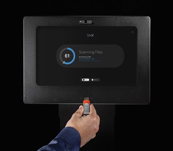

Secure Media Exchange (SMX) from Honeywell Process Solutions (HPS), Houston, is aimed at USB-borne threats and was designed based on feedback from chemical and other process customers and cyber-security experts.
“The bottom line was the need for a product that provides maximum security but doesn’t interfere with the normal business and operations of a process control facility,” says Phoenix, Ariz.-based Seth Carpenter, lead cyber-security technologist, strategic innovation group.
As a result, a plug-and-play cellular option was introduced that doesn’t connect to the plant’s network at all but rather to HPS’s secure cloud service ATIX.
“Through ATIX, we monitor and manage the SMX gateways as well, so the customer never has to spend any time maintaining SMX,” notes Carpenter.
ATIX is one of the three key components of the SMX product. Second are the SMX intelligence gateways, the physical units installed at a customer site (Figure 1). Anyone wanting to use a USB removable storage device in a protected personal computer (PC) must connect it to one of these gateways before it’s allowed on to a protected system. The final component is SMX Endpoint Protection Software installed on each PC protected by SMX. It ensures that any USB removable storage device has gone through an SMX Intelligence Gateway before use on the PC. If someone forgets to use the gateway first or the protection on the drive is tampered with between the gateway and the protected computer, the protection software will block the use of that drive.
“So, there is a central gateway (or set of gateways) that performs the analysis and verification of all USB drives. All drives must be brought to one of these gateways before use on a protected PC. There is also software which runs on each protected PC to ensure that users cannot skip the analysis and verification steps. It also gives us the granular control to quarantine and disallow individual malicious files but still allow other approved files to be used as needed,” he stresses.
