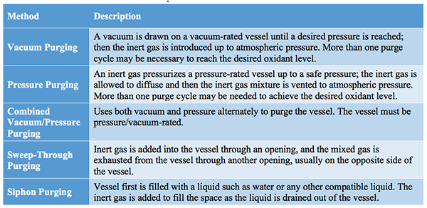

Control of oxidant concentration. Limiting oxidant concentration (LOC) is the minimum quantity of an oxidant that’s required for flame propagation through a homogenous gas/vapor mixture. Replacing oxidant with an inert gas (typically, nitrogen, carbon dioxide or argon) — commonly referred to as inert gas purging/blanketing or simply inerting — can keep oxidant under the LOC. Inerting doesn’t replace the flammable vapors but instead reduces the concentration of oxygen to a level insufficient to support combustion. Note that LOC depends on the nature of the fuel as well as the type of inert gas employed.
INERTING METHODS
Table 1. These are common options for inerting.
You can use a number of inerting methods, including vacuum purging, pressure purging, combined pressure/vacuum purging, sweep-through purging and siphon purging, to reduce the oxidant concentration to a pre-determined safe level (Table 1).
