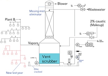

Our 25-year-old vacuum scrubber system (Figure 1) had worked flawless for two years; now, it’s responsible for a toxic release. We increased the vent volume about 20% last year. At the time, the safety and environmental engineer complained bitterly that the capacity already was overtaxed, noting that we had added more demand over the years and the material balance wasn’t well understood. Still, the system worked fine, although operators complained of fumes.
Vent Scrubber System
Figure 1. After a toxic release, plant is grappling with an upgrade project.
Our maintenance manager looked at the equipment and found the following:
• The blower has been rebuilt several times; its capacity was increased once, five years ago.
• The pH probes were abandoned — the system is on the roof and the probes fouled often — and replaced by a titrator; the lab services the titrator because maintenance and operations forgot to keep up on reagents.
• The dike floor has cracked and heaved; equipment additions mean the dike now is slightly undersized (58,000-gal required versus 56,000-gal available).
• The mist eliminator was eliminated years ago because maintenance was annoyed by its fouling.
The project group says it will cost a fortune to replace the system and repair the secondary containment because this system is integral to plant operations. In addition, there’s a dispute over containment volume: operations says we should count the blower containment, which is elevated above the scrubber area and drains into it but the safety engineer disagrees. The project group proposes putting a roof over the area to eliminate stormwater concerns. The maintenance engineer says that’s impossible because the diluted caustic in the mixing shack is cooled by an airfoil cooler.
How should we proceed with this project? Do you see any other concerns?
