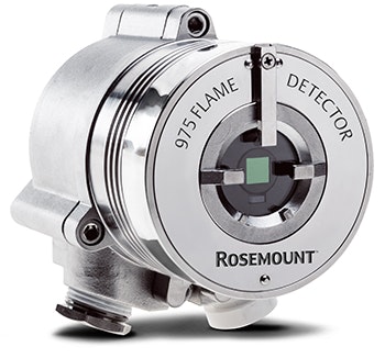

UV/IR Detector
Figure 1. This instrument must detect flames on both bands to trigger an alarm.
• UV flame detectors. These devices suit facilities in which the only fuel sources are hydrogen and hydrocarbon gas. Because smoke scatters UV light to a far greater extent than it does IR, it’s best to locate UV detectors well below roof level as smoke produced by paint, cables or oils may accumulate in ceilings or roofs. To prevent false alarms, inhibit UV detectors during welding, radiography and exposed flame hot work. Just as for IR devices, don’t use UV detectors in areas where you can see direct or reflected flare radiation.
UV detectors are unsuitable for detecting hydrocarbon liquid fires or fires in highly congested spaces. Liquid fires produce little UV light and the dense smoke from these fires greatly reduces detection coverage. In addition, because UV light is most prevalent at the base of an open flame, the devices may not readily detect fires in congested spaces that block the line of sight to the base of the fire. Another consideration for UV detectors is the presence of oil or dust. Deposits of oil film or dust on detector windows can severely reduce flame response sensitivity; therefore don’t use these devices to monitor environments that contain airborne oil droplets or are dusty. UV detectors do best when detecting clean flames (i.e., those from natural gas, pure ethane or butane).
• UV/IR flame detectors. These devices, such as the one shown in Figure 1, combine the characteristics of UV and IR to provide a detector for general hydrocarbon or hydrogen fuel applications. They generate an alarm signal only if a flame is detected on both bands. UV/IR detectors best suit clean flames because few light sources emit as strongly in both spectral regions as clean flames. Such flames afford a shorter detection range than that of a fire from a liquid fuel (ethanol, for example).
