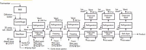

We manufacture astaxanthin by fermentation and decided to switch from spray-drying to freeze-drying or lyophilization because freeze-dried astaxanthin is 41% more active than the spray-dried version and can be stored without refrigeration.
A block flow diagram developed by project engineering summarizes the proposed design (Figure 1); the process involves sterilization, low-temperature drying in a turbo tray dryer followed by freezing and drying in a series of tray dryers ending with a belt dryer.
Freeze-Drying Process
Figure 1. Proposed design has provoked negative comments from a variety of staff.
The design has evoked a lot of criticism. Production complains it’s too complicated and will make it hard to keep the product sterile. Corporate management says we can do away with the sterilization because the freezing process will eliminate bugs. The construction manager argues that maintaining a vacuum between the dryers and even in the dryers themselves will be tough: he suggests going with multiple batch dryers instead. Research counters that the continuous dryers will produce a more-consistent product, even more so than the spray dryers, which are batch. Our safety manager is concerned about dust in the belt dryer. What do you think of the design?
