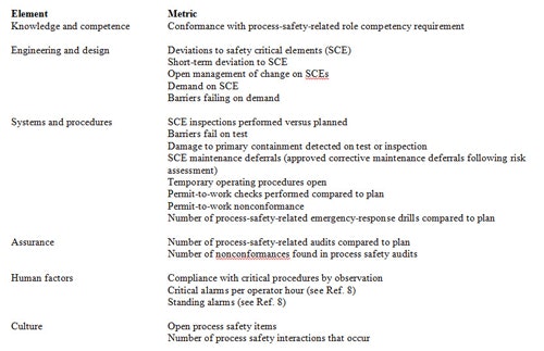

Table 1. Each functional safety element has at least one lead metric.

Each metric was selected solely on its merit. Only later were the metrics assigned by consensus to elements; at that stage it was found that each element had at least one metric. Table 1 lists the metrics with their corresponding element.
