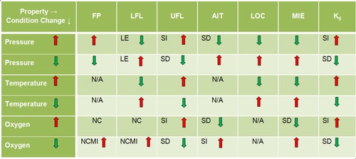

Impact Of Process Conditions
Table 1. Various flammability properties of liquids and vapors change as pressure, temperature or oxygen level increases or decreases.
LE = little effect; NC = no change, NCMI = no change until nose of curve then minimal increases; SD = significant decrease; SI = significant increase; and NA = not applicable]

Processing conditions, e.g., temperature, pressure and oxidant concentration, affect flammability characteristics such as FP, LFL, UFL, AIT, LOC, MIE, Pmax, and Kg (Table 1).
Very limited data on the flammability properties of chemicals or chemical mixtures at low and elevated temperature and pressure are available from public sources. So, most situations require experimentally determining flammability properties under representative process conditions.
